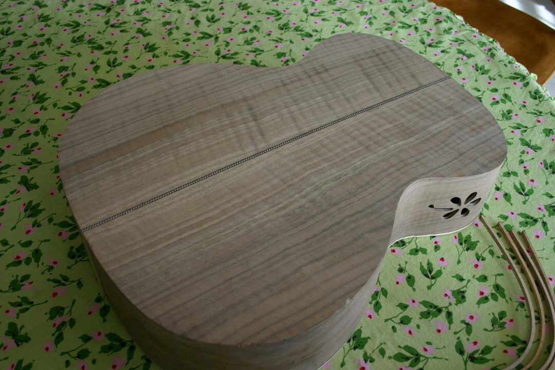

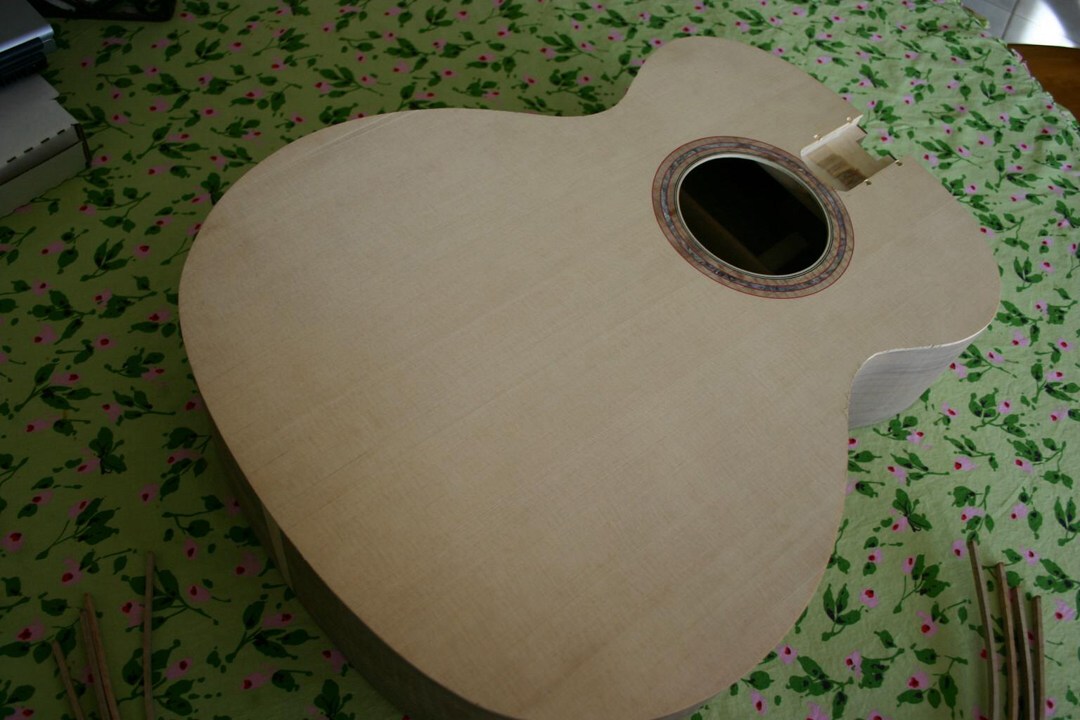

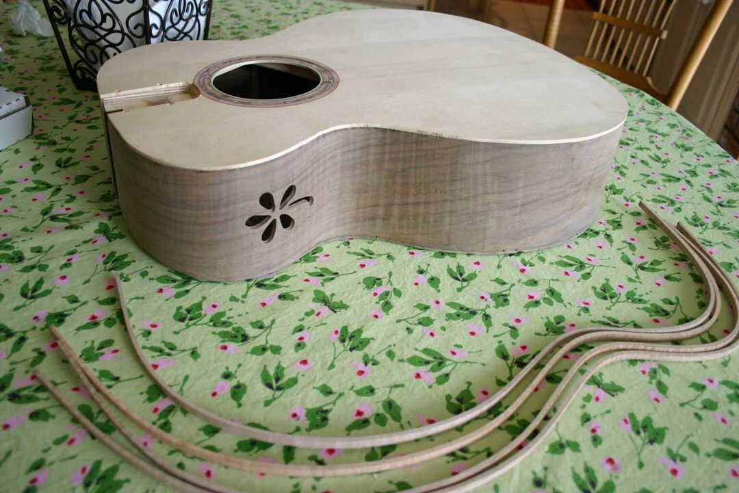

Finally I made time to close this one up and its ready to be routed for the binding...
Walnut with sitka top and will take some nice flamed maple bindings.
peterm38774.8439930556

Peter, love the sound port. Is that box extra deep, or an illusion from the camera angle?
Larry

Larry, its the angle!
Personally I think the top wood plays more of a part how the guitar is going to sound that the back and sides wood. Of course the bracing,box size and many other factors will affect the way the guitar is going to sound but as far as wood is concerned the top is the main factor.
You will find many people that agree with me and many that tottally disagree and I guess thats the way it will always will be thus a lot of controversy on that matter.
I look at it this way:
I love the brightness of a nice stiff Sitka top and the walnut is a beautifull wood and very pleasant to work with!
So i do think Sitka and Walnut make a lovely combination!

Peter, very nice looking box! I really like the sound port, I was thinking of doing one very close to that myself.
BTW, that's a very nice set of walnut!

Peter, is there no taper to the back on this guitar? Looks that way in the pics. If so, what's your thinking behind this?
Nice sound port and walnut. She's looking good.
PostPosted: Sun Feb 26, 2006 1:49 pm
yes, there is a tapper... 4" at the neck and 4.5" at the tail. Hard to see on the pics
I wanted a less of of taper on this one to experiment with different configurations

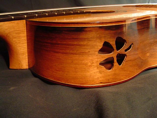

I'll add yet another "I love the soundport". I don't know why it didn't
occur to me that you could do something other than a circle or oval for a
soundport!
...now I need to see if I can figure out how to route out the Nitanny Lion
logo as a soundport...
Jay

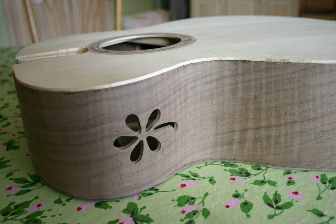

Lookin` good Peter! I like the origionality with the soundhole. Whatcha got goin` on with the bolt-down FB extension?
PostPosted: Sun Feb 26, 2006 4:48 pm
Coe, what do you mean?
PostPosted: Sun Feb 26, 2006 5:08 pm
Posts: 1075
First name: Coe
Last Name: Franklin
City: Decatur
Just saw the holes on each side of your Fb cutout and was wondering if it`s a bolt-down.

Nice work Peter! What did you use to cut out the port?
It looks great
PostPosted: Sun Feb 26, 2006 6:24 pm
Coe, you are right!
Dave I used a Downcut carbide router bit, plenty of files and determination and of course time mixed in with patience!

Looks like we are on to something here. Great minds think alike. I love the soundport!
PostPosted: Mon Feb 27, 2006 2:38 am
Robert, you even lined yours from the inside with maple?
Just like I did!! Looks awesome!
